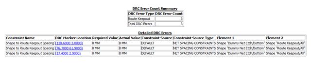

I have fiducial marks on my board and i am getting error under unassigned shapes/drc as shape to route keepout error. There is no route close to this fiducial.
The orange line is my route keepin boundary. When i move this boundary such that fiducials are outside this boundary, then i am getting
additional errors as shape to route keepin. How to get rid of these?

    HI, your fiducial should be built with a "route Keep out", on all layers. not "route keep in". This should fix your problem., i hope this works for you. Cheers

    Hi It is defined as Shape to route keepout on all layers.

    You can't "completely" fix this because you have placed the Shape of the Fiducial and then surrounded that with a Route Keepout. Route Keepouts don't allow Shapes so you get the error. Waive the DRC is about as good as it gets. You could add a "Shapes Allowed" Property to the Route Keepout but this could, potentially, allow "any" shape into the Route Keepout, which would be undesirable.

    1) Top etch pad; in the pad editor I specify a 'Keeput' region (to keep etch away from it); Make sure the soldermask gets pulled back to expose the pad and clearance to copper too.
    2) Have a DFA Place Boundry defined for it the size of the soldermask pullback
    3) In the layout I have a DFA Constraint to keep any components away from them
    Easy, quick, simple.

    Hey, after I have seen your comment. I went back into my fiducial to see how I made my part. Because I never get those DRC;s.  I made the part using a mechanical SMD pin instead of a shape.
