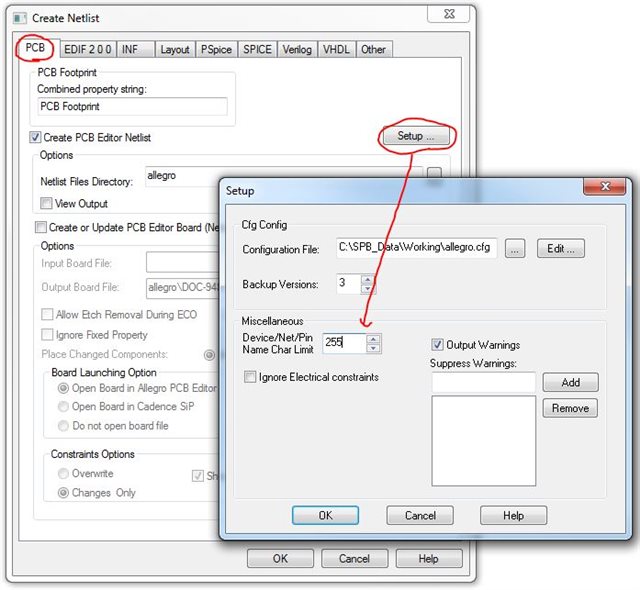

    Tools/Create Netlist/Setup
    Under miscellaneous, set the device/net length to 255
  • CadAce2K
    CadAce2K over 6 years ago in reply to CadAce2K
    FYI - inside allegro, make sure you set this too. Setup/Design Parameters

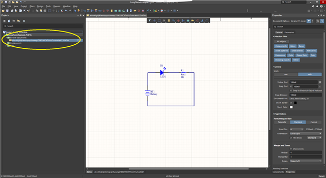

    I made a simple Altium Project so I could show the issue. The following images will show that I made a schematic file that has more than 31 characters: abcdefghijklmnopqrstuvwxyz78901AllOfThisIsTruncated1.SchDoc, the English alphabet plus five numbers, equals 31 characters. You will not see AllOfThisIsTruncated1. This is being truncated during the translation process. I cannot set the 31 character limit unless I have the schematic open. Plus, PCB Editor is already set at 255 (I think it is the default setting). I need to have the ability to have AllOfThisIsTruncated1 to be included also. Is this possible?
