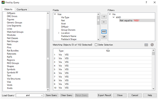

    on the find filter you need to open "Find by query"
    then set up the filter and save the query as shown below.
    when you select the object, you check "By Saved Query" and select the one created.
    in my case i created a query named "gnd."

    Hi masamasa,
    Many thanks for your help!! It works.
