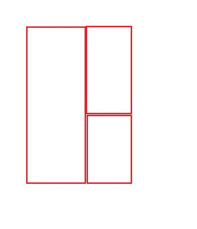

I vaguely remember able to anchor the three tabs ( Visibility,options,find ) in the style below:
However I cant seem to get this going in my version of allegro 17.2, Currently the visibility tab isnt anchored and I wish all three tabs to be anchors. Essentially I wish to be able to anchor the tabs in the follow style on the left:
Any help on this issue would be be of great help as a I cant for the life of me to get them all to anchor in the above style. Thanks!

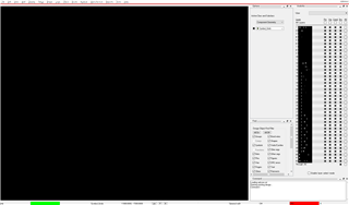

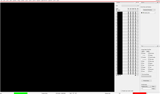

    you can place them as i was able to do it with 17.2
    you have to move them until the blue window shows up as shown below.
  • larry briski
    larry briski over 5 years ago in reply to masamasa
    May be Attle is looking for a solution such that the command window is the same width as the display window as was available with Allegro 16 and previous versions.   This results in the Options, Find, and Visibilty tabs being the full height of the Allegro canvas.   With that capability you can stack two of those tabs in a column.  I truly miss that capability with Allegro 17.
