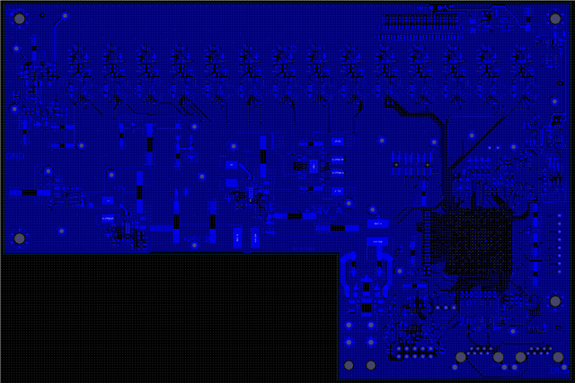

I have a GND shape, covering the entire top plane, which is giving me a headache. Manually updating the shape or any other edit that indirectly updates the shape takes forever. Well, it takes at least between 30 and 60 seconds and Allegro becomes unresponsive during that time. Allegro even shows as Not Responding in Windows Task Manager.
What can cause this behavior? I suspect that there's some setting in Allegro somewhere that should be changed.
I'm using Allegro 17.2 and Windows 10. Computer has an Intel Xeon E3-1505M v6 @ 3.00GHz CPU and  has 32 GB RAM so it should be fast enough.
It's a medium sized board as shown below.
/F

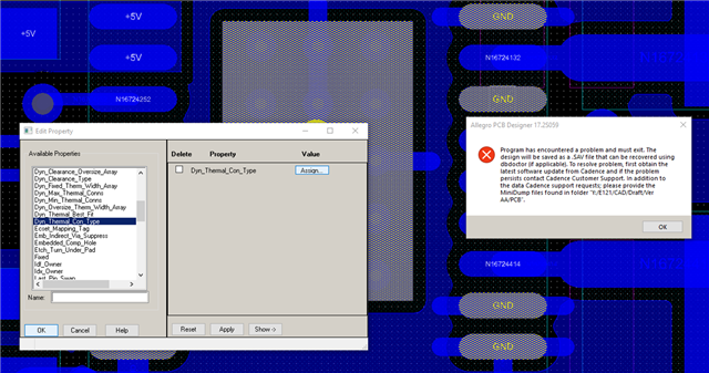

    Thanks for answering. I'm using Allegro 17.2-2016 S059 [9/10/2019] Windows SPB 64-bit Edition. The Database Check doesn't find any errors and the Performance Advisor mostly complains about "Generated positive dynamic shape has no voids."
    Out of curiosity I had run the DesignTrue DFM Wizard, which created a lot of DFM constraints. All these constraints were, however, disabled, but I will delete them and see if anything changes.
    OpenGL is not disabled. I have the "shape hide" tick box in the Visbility pane, but when working with a shape I prefer to have them solid.
    I will have a look at the link. Thanks.
    It's not just the shapes that are suffering from bad performance. An edit of any kind may take an unacceptable long time. As an example, right clicking a pin to bring up the right click menu and then open the Edit property dialog box may take more than 30 seconds. The "progress" circle spins and spins before the dialog box is opened. Even rotating text may cause Allegro to hang for quite some time. Most of the time it recovers, but I've had a number of crashes as well.

    I know this has nothing to do with your issue, but when do you have thermal relief on the Exposed pad?
  • Fredda
    Fredda over 6 years ago in reply to Wild
    Guess what I was about to change when Allegro crashed on me...
