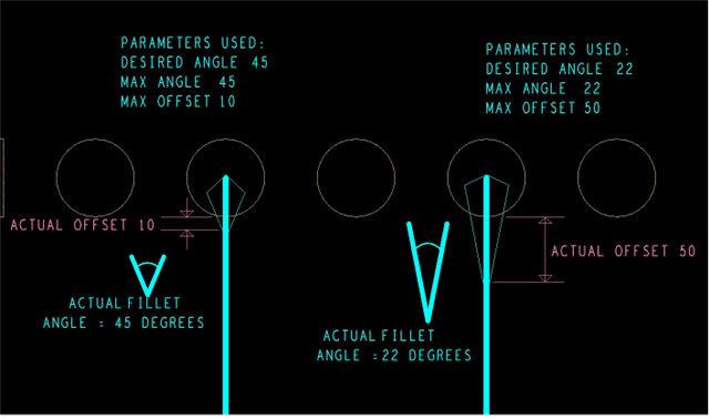

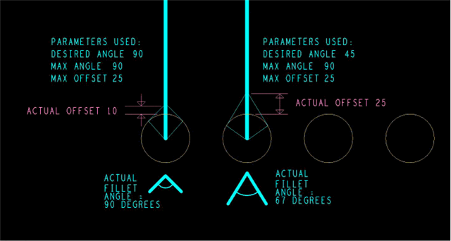

Hi All,
Is there any online documentation or can anyone here help me identify what these menu options do?
  • mcatramb91
    mcatramb91 over 6 years ago
    One suggestion is to click the Help button in the form which should take you to the documentation which explains the options in the form.
    There are a couple of cool images in the docs that help describe the different options in the form as well.

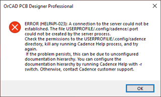

    mcatramb91 Thank you for the information. I will check out the image that you provided. I have tried to use the help button in the past, however, I keep getting errors. Here is an example of the error I get when I press any help buttons:
    Perhaps if this error would not keep occurring I would not get so frustrated. There is a lack of documentation for OrCAD products online.

    It should work.  Maybe the documentation index needs to be generated or re-generated.  Try going into the main documentation. Help > Documentation, this should generate the index if it does not exist.
    Another alternative is to access the HTML Documentation directly where the software is installed.
    C:\Cadence\SPB_17.2\doc\cmdrefmast\cmdrefmast.html (NOTE: C:\Cadence\SPB_17.2 is the default location for the software install)
    This will open up the Command Reference, Select G and then GLOSS PARAM FILLET to jump to the information about the form.
    I don't want to leave you totally stranded in case this does not work so I attached a PDF of the help section for GLOSS PARAM FILLET
    0640.GLOSS_PARAM_FILLET.pdf

    Thank you for the pdf. I very much appreciate it. I have tried to use the Help > Documentation link previously and it also gives the same error and never generates an index. I will be calling customer service for assistance today to get this issue with help to be resolved. Thank you for the idea to bypass help altogether. I will try it if I get no joy from customer service.
    Again, thanks for your help. Have happy and safe holidays.
