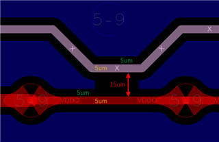

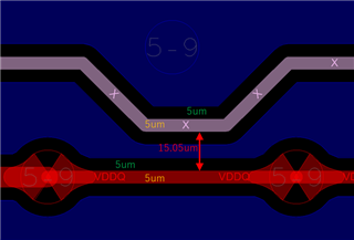

i have a difficult time with figuring out how to manage this spacing issue.
i would like to place a dynamic shape between two clines with a 15um gap.
i set the spacing between cline and shape as 5um and the minimum aperture of gap width on the dynamic shape parameter as 5um.
but i can not get a dynamic shape between the two clines as shown below.
if i set the gap not as 15.00um but as 15.05um, i can get a dynamic shape between the two clines.
did i set up something wrong?
is this a roundup issue or a unit issue?
is there a way to place a dynamic shape with a 15.00um gap?
  • avant
    avant over 5 years ago
    Might be a tolerance issue.
    You could try reducing the aperture gap slightly.
    5um seems extremely thin for a PCB trace.
  • masamasa
    masamasa over 5 years ago in reply to avant
    thank you for your reply.
    i just gave the 5um traces as an example.
    i am actually designing 1.5um traces on a package (not a pcb).
    so a 0.05um difference is critiacal if designing 200 traces in one row.
    i am in this forum as the allegro package designer uses the same pcb editor and most of all i am not getting any response in the ic packaging forum.
