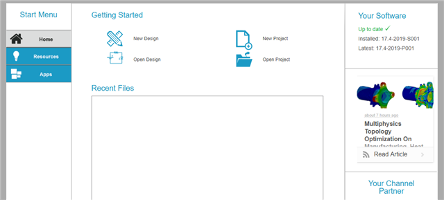

Hello.
What can i do to activate the Recent Files list?
Regards
Urs
    Which Cadence product are you using? You've asked your question in the "Feedback, Suggestions and Questions" forum which is for issues with the forums, not for technical questions, but if you state which product you are using (I don't recognise the screenshot), I'll move the question into an appropriate forum.

    Thank you. It is the OrCAD Capture CIS, 17.4-2019-S001.

    In Capture.ini the Recent File List ist present:
    [Recent File List]
    File1=s:\smg\elektro\orcad\videoanlage.opj
    File2=s:\smg\elektro\orcad\vermessung.opj
    File3=s:\smg\elektro\orcad\nemo.opj
    File4=s:\smg\elektro\orcad\mephisto.opj
    File5=s:\smg\elektro\orcad\bwaplusmini.opj
    File6=s:\smg\elektro\orcad\qa.opj
    File7=S:\SMG\ELEKTRO\ORCAD\LIBRARY\JMAG\KOEPFE.OLB
    File8=s:\smg\elektro\orcad\library\jmag\koepfe.opj
    File9=s:\smg\elektro\orcad\warnfunk.opj
    If i can solve this problem, a big step ist done. Next will be the not working PDF-export (error-message, same as lot of us have) and the printer-bug (sheet from laserprinter comes completely black). But i will take it step by step.
