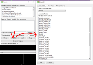

Hi i'm jay,
I am struggling to find the one of property to extract the report.
if I extract the "Etch Length by Pin Pair Report" at the quick report, I can see the "pin pair" property like below pics
so I thought I can customize the list of property that I want to have
I found out the each list at the "Repots" window with "New/Edit" command
I found the Net Name and Etch Length properties but I couldn't find the "Pin Pair" property.....
If you know the location of "Pin Pair", please let me know
Thanks
  • DavidJHutchins
    DavidJHutchins over 5 years ago
    I think the "Etch Length by Pin Pair Report" is one of the newer reports that not based on the 'extracta' command files, which is why you can't find a way of controlling by 'pin pair'...
