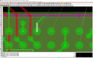

HI, last year, after I set up differential pair and went to route it, the two line would go together with one click.

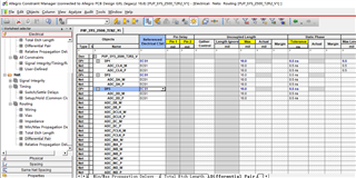

this year I changed a new computer and do the same thing, I setup the differential pair in constraint manager, and everything shows OK.I can see the setup pairs are right there in the constraint window, but when I begin to do the routing, the pair can't go together, they still like single routes, I mean one click can pick up only one net, not the pair together.
I opened the old board file which works fine on my old computer, it works good on my new PC. so did I miss something before setup the differential pair?.

    Hi, after every possible try, I found  when first routed out a small part of the net, stopped and then begin a new routing start from the small net, it works. but still feel it is not convenient. any suggestion?

    RMB and check whether you have selected single trace mode, in that case uncheck and route the DP
