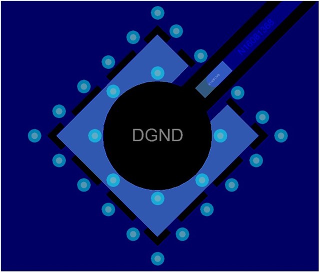

I am trying to connect to the ground pin on the Rosenberger 19S101-40ML5 SMO connector shown in the image. I have created the footprint using shape symbols. Now, the center of the GND pin is not metalized. I want to connect the GND VIA to one edge (top edge here) of the GND pin. How do i do that? I can recenter the shape symbol so that the center falls at the center of the metalized portion on the top edge, but then if i want to connect to the left or right edges in another instance i have to recreate the symbol with a different shape symbol (center of the pin moved again), i guess. Is there a straight forward way to do this in OrCAD, so that i can just snap to any metalized part of a pin?

    We use the same part in High Frequency ATE boards.  The outer pin should be a full pad connect, note the copper voids for thermal relief and the pin origin must be within the copper shape of the outer pin.   The center area must be free of copper, or you will get unwanted parasitic capacitance to the signal pin.  The route from the pin is a co planar controlled impedance.  Good luck.
    BTW the impedance in this case is 90 Ohm - my bad, I just double checked the impedance.  RFinley is correct, 50Ohm.

    Radio is mostly 50 ohms.  Risky assumptions.   My impression is high-speed digital is around 100 ohms.
    Kudos on coplanar waveguide.  We usually pull ground away and do microstrip.

    thank you for the info, and the bonus tips. Our application is low frequency (30 MHz) and uses lumped element matching, we do not need coplanar waveguides or microstrips, the traces are very short compared to the wavelength at 30 MHz.
