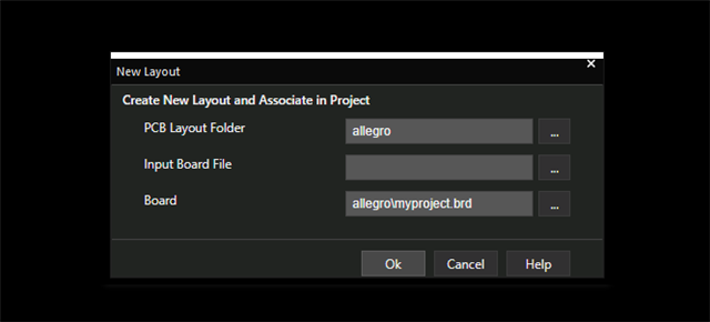

After I run data sync, it stucks. I waited for hours but it does not process or ends. What could be wrong with it? I am using orcad 17.4 version
  • steve
    steve over 5 years ago
    So what exact version are you using from Help - About? If it's 17.4-2019 PXXXX then make sure you get the latest version from Download manager or http://support.cadence.com. The latest hotfix is 17.4-2019 S009.
  • geovany
    geovany over 5 years ago
    Make sure you don't have any virtual machines running. In my case I ran genymotion which caused this error.      2 player games
  • AvengerThanos
    AvengerThanos over 5 years ago
    Browse the path of PCB board again then perform design sync...as Steve said check with hotfix version
