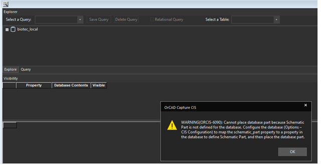

Dear Orcad Expert,
I have been an Orcad user for quite a while, but never create or set up a CIS environment. after I set up the CIS step by step, it almost works but the last step, place the Database part.
1.

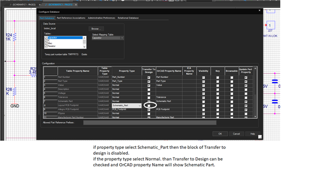

2. When I setup the CIS configuration, Here is my observation, I know it could be the problem, but need help to solve it.
as shown in the picture, in the configuration table.  Table property name is "Schematic Part",
if the Property Type is "normal", I can check the Transfer to Design, and the OrCAD property name will show "Schematic Part" automatically.
if change the Property Type to "Schematic_Part", then the "Transfer to Design" block is disabled. guess something wrong here.

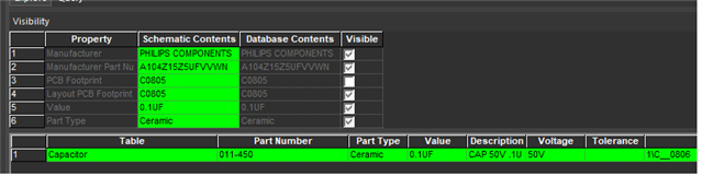

3. but If I click on the schematic, choose a CAP, right-click and choose view database part, I will get some green table like this
please give me some instruction to solve this problem, thanks,
