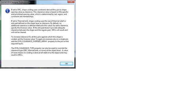

    I think your sceenshot ID is wrong.  Screenshot 2 has the orange so let's discuss.
    Do you see anything obviously different between the orange shape and the pins?  I can't see any pin space clearance on the orange shape.
    What is the clearance rule in the global shape parameters?  DRC or Antipad?
    Did you read this help box?

    There is no pin space clearance on the orange shape. This is precisely the issue that I am having. It should have a void clearance around each pin, but in this case the orange copper pour (with dummy net) connects to all pins and therefore DRC errors at all those pins.
    I did read the Help box. I have 8 mils as default spacing set for "Thru Pin To" all. I also set DRC for thru pin under "Clearances". You can see these in the screenshot below.
    Please note that I assigned the shape to GND net this time. The 4 GND pins (2,4,6,8) are connected to this net but the rest of the pins still have this DRC error. I have also tried setting Thru pin under Clearances to Thermal/anti with 20 mils for Oversize value and still got the same error. This error is very strange because I do not get it when I do the same on my first board.There must be some differences in settings that I cannot figure out.

    After looking into how new Board (Wizard) creates a new layout and a few trial and error in new board creations, I have found the answer to my problem. I used default settings in the wizard in creating my second board, particularly the "Generate negative layers for Power planes" option. I left this box checked. To correct the problem, I unchecked the two boxes under Cross-sector Editor -> Physical -> Negative Artwork for the two inner planes (GND and PWR). After that, the orange shape no longer connects to the pins.
    I hope others find this helpful. Thanks.
