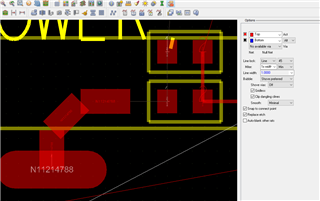

In Allegro 17.2, when I add connects and make 45 degree turns, they appear as partially touching rectangles, not a joining continuous line. How do I improve this?

    Setup - Design Parameters - Display tab and turn on Connect Line endcaps.
