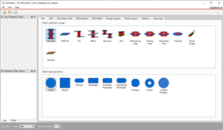

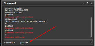

I'd like to launch sub program (padstack) or other program (Sigrity) by command or button without tedious working like finding path or searching Tool name from OrCAD or Allegro PCB Designer tool.
for instance, if I put the command 'padstack' then the 'Padstack' will be opened like below. Sigrity as well
or what if I have to write SKILL code for this, then How to launch the .exe file by SKILL code?

    the command to launch the padstack list is padeditdb.
    you can always find out what kind of command you are performing by typing scriptmode +e in the command line.
