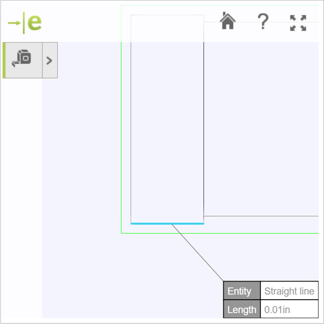

I am able to import the DXF but the shape size does not match the original DXF.
My DXF units match the units used in the DXF file.
When I click "view selected layers" in the edit/view layers screen my command screen gives me this error...
*Error* fprintf/sprintf: format spec. incompatible with data - "Format is 'dxf2a -$ %s -u %s -v %s -a %d %s %s %%s %s', argument #1 is nil"
After I click import the shape does appear but I get this message...
dxf2a completed successfully, use Viewlog to review the log file. Incremental option off, existing design was replaced. Re-open design to restore.

Looking into the DXF preview on eDrawings I get these measurements which don't make sense to me.
Maybe there's something I'm missing here but how is it that the line is 0.01" and the distance between the two lines its connected to is 1.18"???
