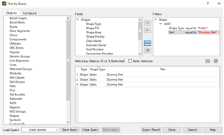

    u can create a query for selecting static shapes with dummy net as shown bellow.
    although this is still a manual operation, u can select all 900+ dummy net static shapes at once and assign a new net to them in a single operation.
