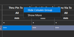

Hi All
I made a mistake clicked "Hide Column" but I don't how to restore my tab to original state on Constraint Manager
please let me know the solution
regard
  • oldmouldy
    oldmouldy over 4 years ago
    Use View>Show All Columns in Constraint Manager to restore any hidden columns.
