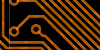

I was wondering if there is a skill on allegro that will add the name of net next to the cline corresponding to that net.
So far I've only been able to do it manually, but there is a lot of clines is there a short curt?

    Allegro has the ability to display the net name on Clines, Shapes & Pins. Go to Setup Design Parameters on the tool bar. You should see the option on the form that pops up.
    All the best.
