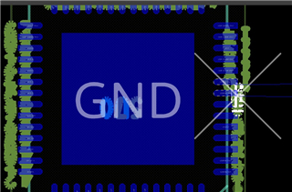

I am trying to route the differential pairs of USB 3.1 but having trouble with that.
I have set rules for differential pair as follows:
Line Min width = Line max width = 15 mil
Neck min width = 5mil
Neck max length = 50 mil
Differential Pair Min Line spacing = 5mil
Differential Pair Primary Gap = 10 mil
Differential Pair Neck Gap = 0 mil
Differential Pair Tolerance = +/- 5mil
But when I try to route the differential pair to the IC pins, it does not allow me. I am attaching picture of that as well.
I am using USB5744 IC, QFN package.
Can anyone help me to solve this issue ?
Thanks

    As per the datasheet of USB5744 IC, pitch is 0.40mm~15mils. In the constraints you have set the line width is 15mils and primary gap is 10mils. These constraints cannot be achieved due over size in constraint value. Reduce the either of the values to route.
