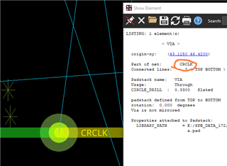

Allegro PCB remove the net property when user disconnect the Cline with via as an default
see the example below
Via has the net property if it connect with cline
but if I disconnect the both side cline, the via lose the net property
how can the via keep the original net information when Cline removed?
regard
  • steve
    steve over 4 years ago
    Yes - In Constraint Manager go to the Properties - Net - General Net Properties and enable the "Retain Net on Vias" property for the required nets.
