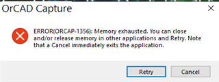

While trying to Create Netlist for my project (I uploaded it in zip file) I get the following error:
The format on which I'm trying to create the netlist is by choosing orIntegra.dll in Formatters, and {P\N} in PCB Footprint:
CM-FX6_ORCAD_16V2.zip
I tried to close every other application but it didn't work, I can create netlist for other smaller project. what could be causing this problem?
after clicking "retry" the whole software stops responding and have to restart it.

    Hi, no problem creating a netlist at this end. Worked fine.
    Try close capture out. Then invoke the windows task manager. Go to processes and make sure Capture is not running. If it is select it and then hit the end process button.
    When you restart capture run it as an administrator.
    All the best.
