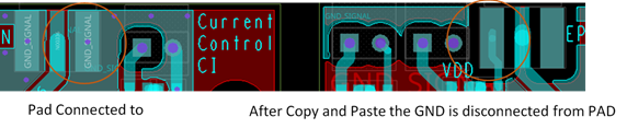

Hi everybody,
I have a small PCB and I want to make a copy of this, like Panalization. I have checked all objects like "Symbols", "CLines", "Shapes" etc.
Afterthen I have copied and paste the board. Thats works, but the Net Names were not copied. This caused that the e.g. GND Net is not connected to the pads.
Everybody knows this issue?
Best regards
