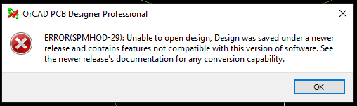

           I have version Orcad PCB Designer 17.4.
I am trying to make a file that works in 17.2.
I am using the option Export-> More -> Downrev Design
I get the popup
After saving I sent file to manufacturer. When he opened He got the following,
He has 17.2
How can this be resolved?
Thanks.
  • steve
    steve over 4 years ago
    First thing to do is to update to the latest hotfix. 17.4-2019 S019 then try again. You can access this via Download Manager or http://support.cadence.com. I would also recommend that your manufacture updates his 17.2 to the latest hotfix S077. There are some DFX features that may not be removed when the downrev is complete hence you need to update 17.2 as well.
