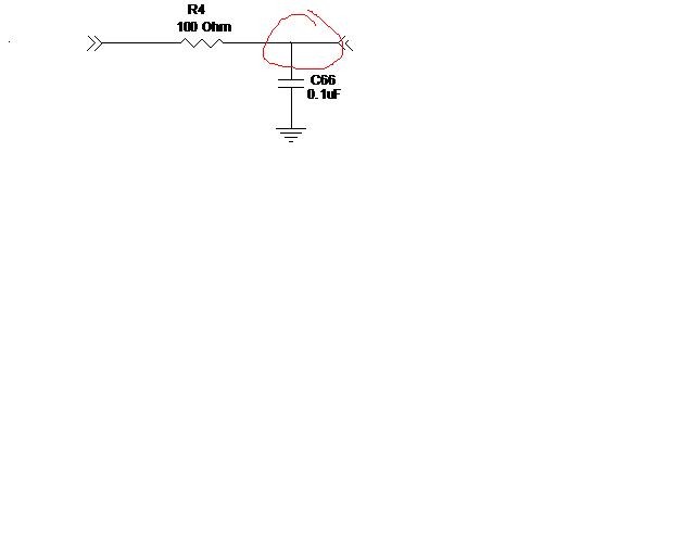

Is there a way to increase the size of the 'junction' (dot) in Allegro Design Entry CIS?  We use the software for graphical communications and not necessarily just netlisting and the visibility of the 'junction' symbol is practically nonexistent.

    If you zoom in real close it appear that it is not a dot but a dangling segment. It also appears to be off grid which would indicate you didn't have snap grid clicked on.

    I think that was just a distortion of the jpg image. HOWEVER, your comment led me to the answer: Options - Preferences - Grid Display - Grid Spacing - s/b 1/1 of pin to pin. THANKS!!!!
