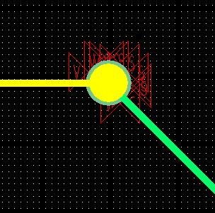

Hi all,
I'm new to Allegro tools
and I'm experiencing a problem
when routing through power planes.
I've setup this simple stackup
top
gnd       neg. plane
vcc        neg. plane
bottom
If the router (manual or auto)
places a via between top and bottom layers,
the DRC shows a spacing violation with gnd.
'Item 1
'  Class:           DRC ERROR CLASS
'  Subclass:        GND
'  Origin xy:       (1503.56 1230.00)
'  CONSTRAINT:      Shape to Thru Via Spacing
'  CONSTRAINT SET:  DEFAULT
'  CONSTRAINT TYPE: NET SPACING CONSTRAINTS
'    Constraint value: 5 MIL
'    Actual value:     0 MIL
This happens when the power planes have been etched
(either before or after routing).
Why there is no clearance beetwen the via
and the etched planes?
How can I avoid this error?
Giohdl

    1. make sure in the cross-section the planes are "planes" and negative is checked.
    2. use dynamic shapes.

    Thank you very much.
    I had omitted the second point.
    Regards
