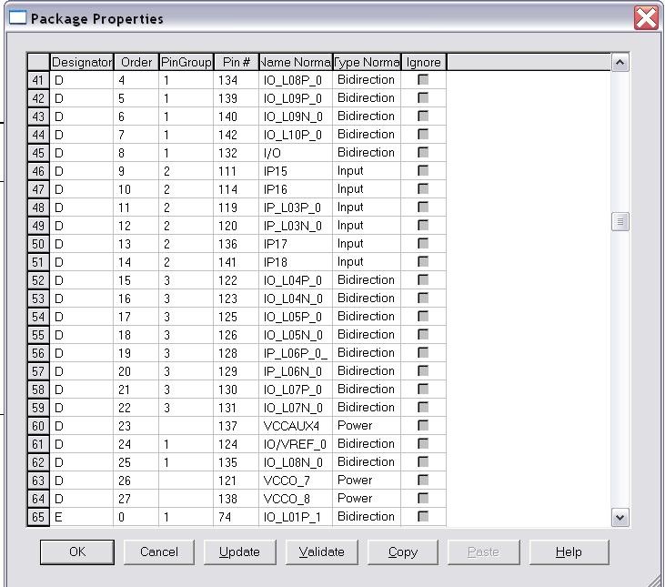

I tried to swap pins on a component and it keeps giving me this error: Pin is not swappable because the swap code is zero ... pick again. How do I fix this so that the pins can be swapped? It does it with all of the components on the pc.

    Where is your netlist originating? If it is coming form Concept, pin swapping is enabled through the PIN_GROUP attribute on the pin in the chips.prt file. Pins of the same function and having the same PIN_GROUP value, will be swappable.

    I'm using Capture to netlist.

    Same answer but it's done in edit package in Capture

    Hi Timprotor,
    Step1: open library
    Step2: choose corresponding part
    Step3:view--à pakage
    Step4: Press CLT E
    Step5: see the window package properties
    Step6: see package properties contain pin group column.
    Step7.define corresponding pin group example:
    • I/O pin group code :1
    • input pin group code :2
    • output pin group code :3
    step8: press o.k.
    step9: same Part update DSN file
    Step10: take new net list.
    Step11: import allegro.
