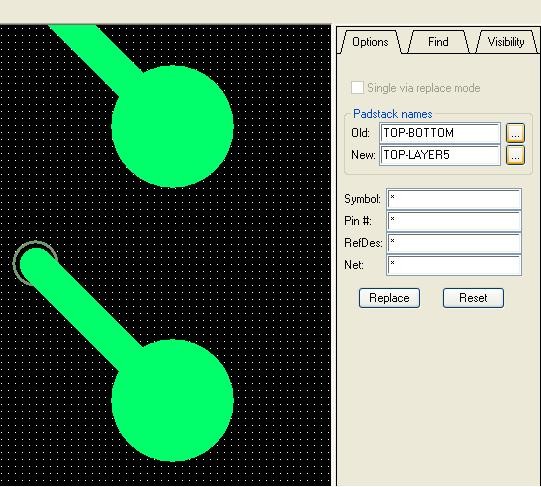

Hi, I have a BGA which has been fanout at board level not library level, all the vias are the same and go through Top to Bottom. I want to replace some of those by blind vias, which I have already defined, but I can't select the vias by going through Edit->Change. Does anybody know how to accomplish this? Thank's Regards.

    Tools -> Padstack -> Replace
    Ensure that "single via replace mode" is checked
    KP

    Thank's for quick reply, as you can see in the attached pic "Single via replace" is not enabled. What can be done? For example what should I do to replace the via showed in the image? Thank's Regards

    You need to select a via before the single via replace mode is enabled.

    Ok, now it works.
