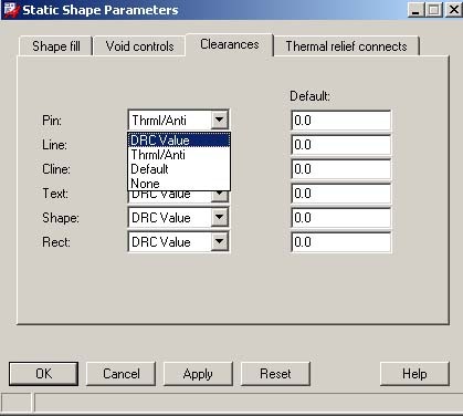

Is there a way to have all internal plane layers a dynamic shape and solid and both external layers have a hatched fill? Thanks

    Hi Prajakta,
    In 14.2, the find filter will be all grey'd out if the shape is dynamic. This option only applies to static shapes.
    KP

    Hi kp ,
    Yes , it works for static shapes ... But it only voids few padstacks and gives a error message.....
    THE FOLLOWING PADSTACKS ARE MISSING THERMAL/ANTIPADS:
    (The pins will be ignored.)

    THE FOLLOWING PADSTACKS ARE BEING VOIDED USING THERMAL/ANTIPADS
    BUT THIS IS LESS THEN THE REGULAR PAD PLUS DRC SPACING: (voids added anyway)

    Can you explain what the above error means ....
    Thanks.
    Prajakta

    It sounds like you are using Thermal / Anti Pad Values for your Clearances and I assume that these padstacks have values which are either missing or smaller that the Pad + DRC. I suggest that you use DRC settings.
