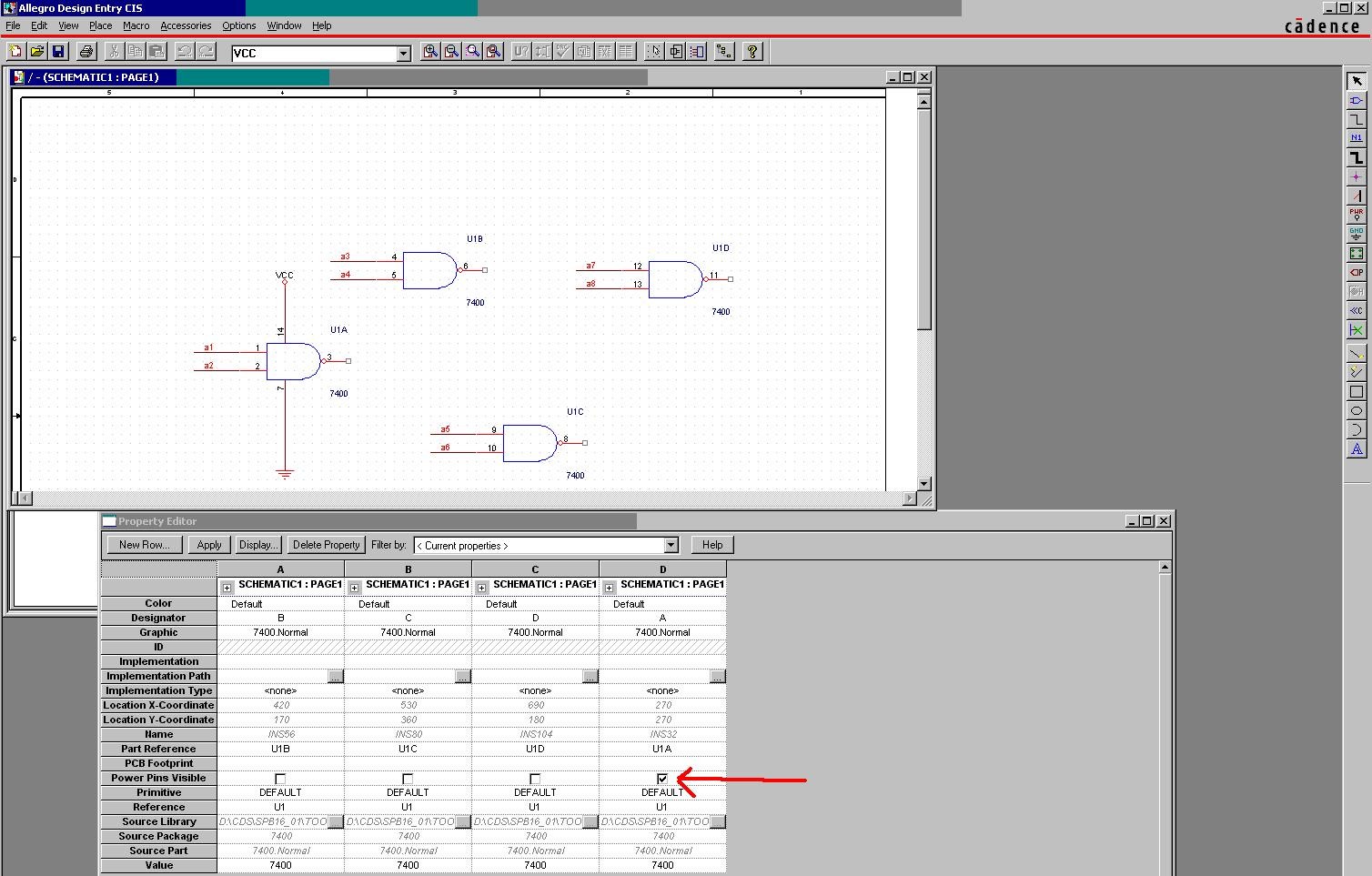

    Here is a simple way to do it.
    Originally posted in cdnusers.org by rbennett

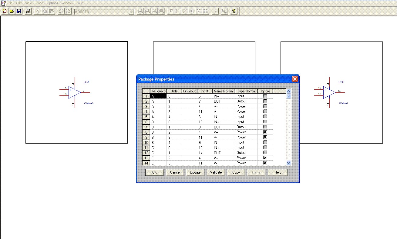

    Hi another way to do it is from the part library, when viewing the part you can View package, then edit properties, and ignore the power pins in the other instances of that gate (as shown in the screenshot) Stephen Grant-Davies QuantumCad

    Opps here it is
    Originally posted in cdnusers.org by stephen@quantumcad.co.uk
