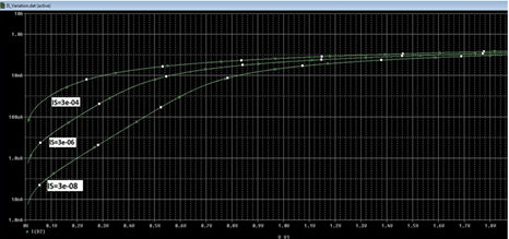

IS (Reverse Saturation Current): Determines where along the voltage axis the I-V curve sits. In Schottky models, IS is typically several orders of magnitude larger than in standard PN junctions — often in the μA to mA range — which is the physical reason Schottky diodes conduct at a lower forward voltage. A lower IS shifts the curve to the right, increasing Vf for a given forward current. A higher IS shifts it left, reducing Vf.

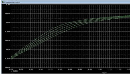

N (Ideality Factor): Controls the steepness of the exponential rise. An ideal diode has N = 1; real Schottky devices typically fall between 1.0 and 2.2 depending on the junction technology and operating region. A higher N flattens the curve — you need more voltage to drive the same current — and also makes the forward voltage more sensitive to temperature variation.

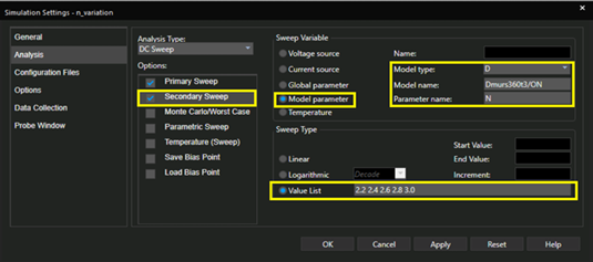

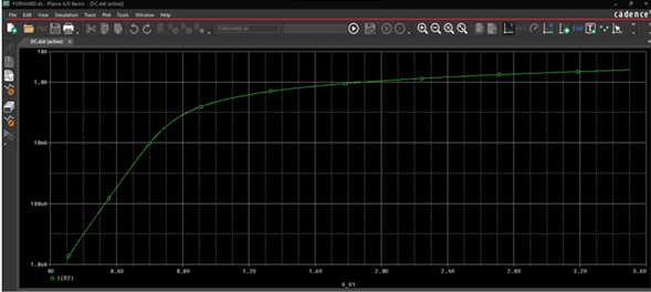

  • Perform a DC sweep analysis on a forward-biased circuit.

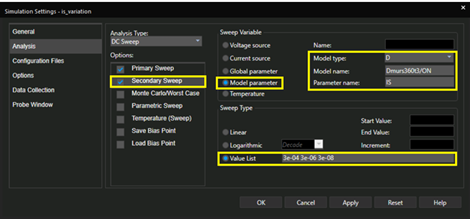

  • Use Parametric sweeps to vary IS and N independently.
  • Example ranges:
    • IS: 3e-04 to 3e-08
    • N: 2.2 to 3
  • Observe resulting changes in forward voltage and current characteristics.
  • Effect of IS (Reverse Saturation Current):
    • Forward voltage drop can be tuned by modifying IS.
    • A lower IS results in a higher forward voltage for the same current.
  • Effect of N (Ideality Factor):
    • Controls the slope of the I-V curve.
    • Changing N modifies exponential behavior and deviation from ideal characteristics.
