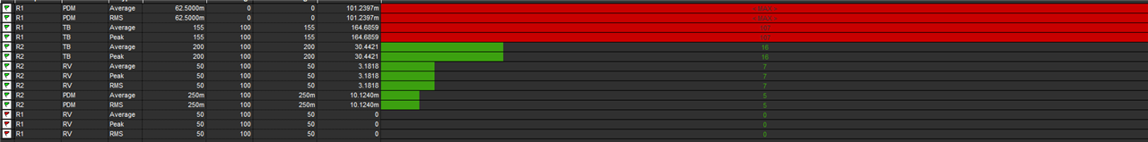

I have a simple resistive circuit R1 and R2, R2 comes from the menu Place / PSpice Part/ Resistor and R1 comes from my CIS Cip database.
I have all the smoke parameters set up the same but for the R1 I have
the following non fatal errors
Voltage Data not found for smoke test RV
Please verify save data and data collections options in the simulation profile
R2 gives me the voltage data expressed as RV but R1 from my cip database does not
Has anybody else found this error and if so how do I correct it

    Thank you for your reply. I can say that Data collection for voltage current and power is set correctly otherwise surely i wouldnt have voltage data for R2
    For statement 2  I have not used port names just 2 resistors and 1 dc voltage source and a pspice ground.here is the pspice netlist
    V_V3 N00133 0 35Vdc
    R_R1 N00133 N00145 R_R1 10k TC=0.00005,0
    .model R_R1 RES R=1 DEV=1% TC1=0.00005 TC2=0
    R_R2 N00145 0 1k TC=0,0
    The main difference is R1 gives me a model statement and R2 doesn't  but if i give R2 a tolereance then R2 has a model statement but it still gives me the voltage simulated or RV as it is called in smoke
    R2 gives me the voltage data but R1 doesn't here is the smoke window from this simulation

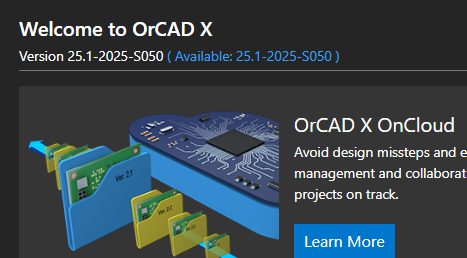

    AAs you can see I am using the latest version of Orcad
    II really need this to work for 1 other thing all my smoke parameters come from CIS CIP and taken from manufacturers datasheets. As you can see all the other smoke parameters for R1 is working correctly
