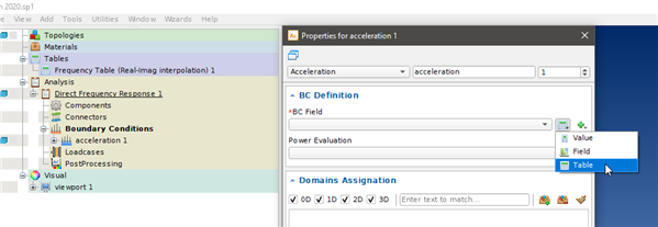

Hi sir, I have defined entries to a table and exported it, but how to assign that table to any boundary condition like acceleration or velocity. While keeping BC field drop down to table, I can't find any option to insert the exported table.
raj.gaurav
raj.gaurav over 5 years ago
Can I assign any exported table to boundary condition or I will have to feed the values in BC field manually?

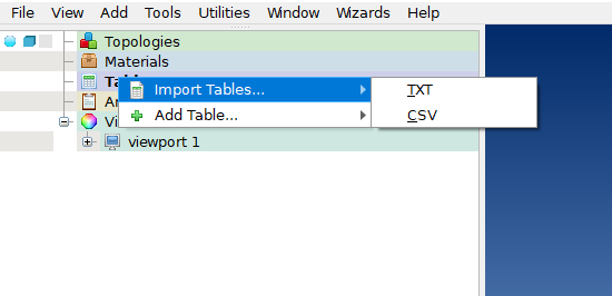

    Hi Gaurav,
    You can import the data to a table as in below image:

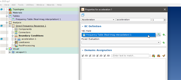

    Hello Gaurav,
    You can refer the Table in any required BC as per the following steps.
    1
    2
    Please try as per this and let us know.
