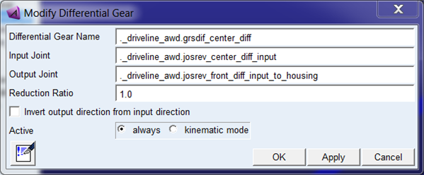

    Also i wonder how is possible that central differential is modeled such as:
    Capture
    where output joint is type single. Afaik it has to be left or right.

    Just for the benefit of others, because Jozef and I spoke about this elsewhere. The template topology is correct.
    1. The torque load path is only through the center diff input.
    2. The modify differential dialog box is not capable of showing the actual connections because it expects a left/right pair of joints, not two single joints. Regardless of this dbox's limitations, the actual modeling is correct.

    Yes Greg confirmed that awd template is correct. Thanks. But i think that better will be if templates are done without special hacks, so new users are not confused.
    Jozef
