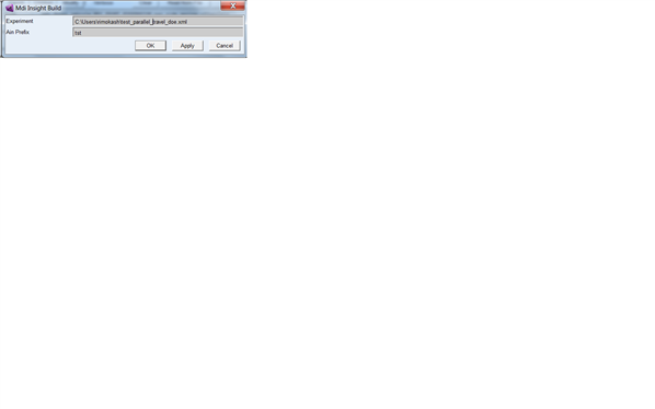

I would like to run my A/Insight DOE external to the ADAMS/CAR interface. In other words I would like to generate the .adm and .acf files to disk. and then run the cases externally.
I have an .xml file that works, ie it solves the cases thru the ADAMS/CAR interface.
In reading the help files I came across the command "MDI Insight Build" which is suppose to write all the .adm and .acf fields to disk.
However when I use this command, pointing to the .xml file that works I get the following error which I can't make sense of:
"Experiment file 'file;//experiment_doe.xml' not found on disk or incomplete, verify proper name and working dir"
Does anyone know how to fix this? Is there another way to generate the input files to disk?

    Hi Joe,
    Could you please simply try without the "file://" part. Something like this
    I hope this helps.

    it works! missed that.
    thanks a lot.!
