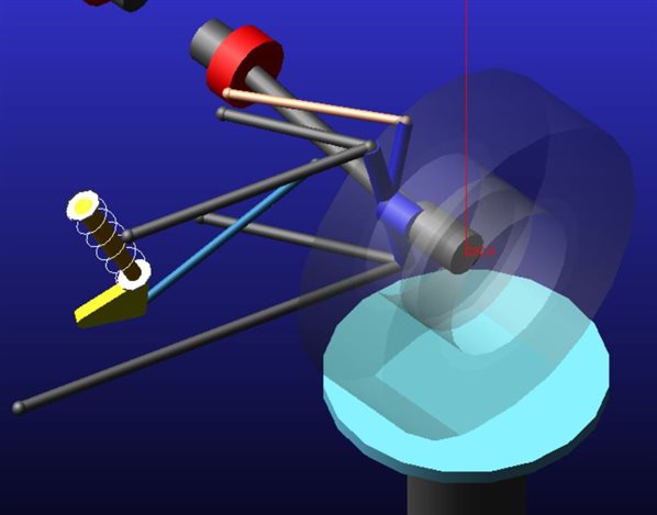

Hello, I am a student at the University of Leeds using A/Car for my dissertation and only have a few months experience with the software.
I have been using the FSAE formula car template and modifying the hardpoints of the suspension components to represent our universities fsae car. Whilst doing some basic single wheel travel simulations I found that the pull rod would move relative to the wishbone and upright when in fact they should have a rigid relative to each other. This meant that pull rod (and rocker and spring) would remain stationary whilst the rest of the suspension and wheel assembly would move under bump conditions. I have since managed to stop this from occurring, however a new issue has now appeared.
During bump travel the pull rod now twists the rocker and then locks fixed, meaning all of the bump travel is absorbed by the deflection of the tyre instead (shown in the attached figure). I have opened the assembly in A/View and checked that the rocker has a revolute joint where it attaches to the chassis , which I assumed would have constrained motion.

    Congrats, then you managed to build an over constrained kinematic that cannot move.
    Introduce some elasticity for example by simply changing joints to bushings.
    If you want a "rigid" wheel, try using 1e6 or 1e9 as stiffness and then use a parallel travel event. (Most likely result: Solver abort due to actuation limits reached)

    Hi, in the FSAE template, pull rod is by default connected to the LCA with a spherical joint. If you have only changed the hardpoint locations and kept the default topology, I would expect the outter end of the pull rod move relatively to the UCA instead of being "fixed" to it. To do a quick check, right click on the joint and do a Info. Check I and J markers and what they belong to.
    If this is the case, you need to go to template level and modify the joint I and J parts. Please let me know if you need any help on changing model topology.

    Thank you for your help! I discovered that the problem was the rocker pivot orientation coordinates were incorrect, which is why it was rotating incorrectly and preventing the spring from compressing.
