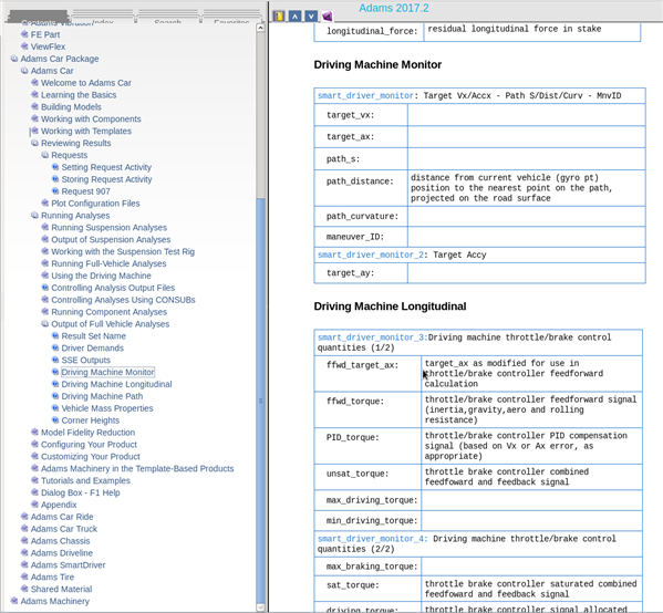

I have looked everywhere in the ADAMS car help and I can only find the suspension output definitions. Where can I find the exact definitions for the requests automatically generated after running a full vehicle model such as:
vehicle_mass_properties
vehicle_statistics
chassis_accelerations
chassis_displacements
chassis_velocities
etc...

    You will find many in the testrig within your assembly. Otherwise look into the subsystems where the measurement is done.

    Partly you can find it in the help.
    Outputs
    Otherwise I always recommend checking the adm-file.
    For example the chassis_accelerations look like this:
    REQUEST/277
    , COMMENT = Chassis Accelerations
    , CNAMES = "", "longitudinal", "lateral", "vertical"
    , CLABELS = "", "Acceleration (g)", "Acceleration (g)", "Acceleration (g)"
    , RESULTS_NAME = chassis_accelerations
    , FUNCTION = USER(907, 2, 833, 824, 833, 1, 1)\
    , ROUTINE = abgVDM::req907
    Marker/833 is the chassis_cm, MARKER/824 is ground.origo, which means the request obviously holds the accel of ground origo relative to chassis.cm.

    BTW: Help also says
    Request 907
    Request 907 (req907) outputs displacement, velocity, accelerations, and body side-slip angle depending on the value of par(2) in the parameter list. Req907 is compatible with both dynamic and steady-state type analyses.
    The definition of the parameters array and the resulting output is:
    par(1) = Branch Flag 907
    par(2) = Request Type:
            0 = Displacement(Angles in radians)
            1 = Velocities
                 (Translational vel. in KPH)
                  (Angular velocity in radians/s)
            2 = Accelerations
                  (Translational acc. G's)
                  (Rotational acc. in radians/s/2)
            3 = Body Side Slip Angle in Radians
    par(3) = id I marker
    par(4) = id J marker
    par(5) = id RM marker
    Any results with a magnitude less than 1e-7 are set to zero.
