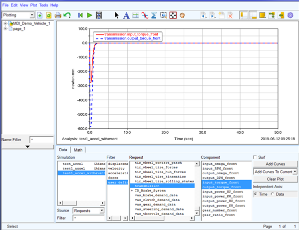

    Capture21
    mail16
    Like the result which I have sent it to you is from Demo-Vehicle Front wheel drive which I have made using your help. In the post-processing it is showing values for Tire force but not for Input and Output torque, So can you tell me what might be the problem?
  • m.derbas
    0 m.derbas over 7 years ago
    I just saw that you were running the Simulation in the Event builder to get These values, that's a big no
    ​The Event builder let's you run the Simulation without relying on the powertrain, as is shown in the attached file of basically the same Simulation, 1 second of full throttle starting at 0.1 seconds
    If you want to see values when it Comes to Transmission then you Need to use the Event builder to debug you System up to a Point where it can pass the static solver
    Attached Files (1)
  • rohan.tiwari
    0 rohan.tiwari over 7 years ago
    Ok, I got your 1st and 2nd Point.
    Can you please elaborate your Last point. I didn't understand that.
