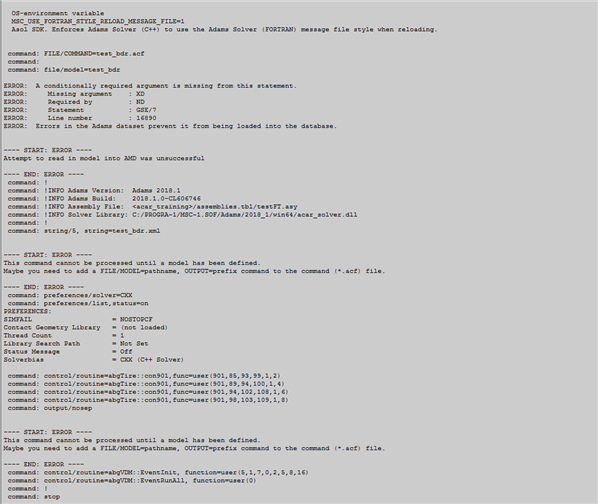

Can someone suggest me the easiest way or the flow chart of converting a demo vehicle into an All Wheel Drive vehicle?

    Try to run your Simulation again in the regular straight line Events, see where your Problem is. It is most probably a Joint that is placed in a wrong orientation or a degree of freedom Problem. If the Simulation in the Event builder isn't telling you more that is (deactivating redundent constraints and so on)​

    mail17
    I am not able to remove this error, can you help me with this?
  • m.derbas
    0 m.derbas over 7 years ago
    go to the adm file generated in your Directory and search for the GSE/7 Thing
    Best of luck ​
