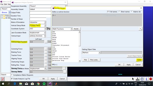

I'm new to Adams Car but I want to simulate a dynamic analysis on Car. I want to define arbitary functions but there always seems to be a syntax error and I could not find any good resources online or on the help function to properly define the functions to run the analyses. Please help!

    Have you looked under "Run-Time Functions" in the ADAMS/View > View Function Builder?
    What exactly are you trying to do?

    I want to run a suspension analysis with displacement excitations given to the tire contact patch in a Suspension Assembly on Adams Car. The menu looking as such as provided in this image. I have not a lot of experience with the software and would appreciate if I could get an idea of how to write correct functions for this menu.

    Have you tried something simple, like "50*sin(2*pi*time/10)"
  • utkarsh.verma
    0 utkarsh.verma over 7 years ago
    Thanks JSlatten!
    I honestly just had no idea how to insert the time into the function, now its all become more easy.
