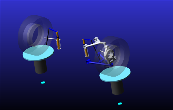

I'm working on building a car model and when I delete the present geometry made on ADAMS and try to import the geometry in parasolid format, I get a macros error (Please refer to attached image). I don't get the same error when I keep the ADAMS geometry and follow the same steps. But, for some reason, the right side of the vehicle vanishes when I make a full vehicle assembly. Could someone please help me with this?

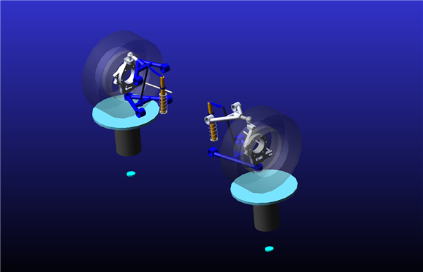

    Sorry about the late reply, yes it does. It works if I simulate it as well. But, when I save it and open again, the geometry disappers.

    Only the right side geometry of import disappers, left side stays.
  • athrey
    0 athrey over 6 years ago
    Here is what happens, if I ignore the error and carry on, everything works (Please refer to image).
    step_1
    But, once and save and open the file again, geometry on the right hand side vanishes.
    step_2
