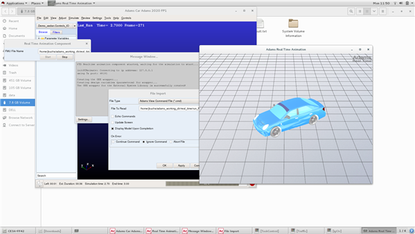

Hello has anybody experience with Adams real tíme animation?
I​ was trying to follow PDF from what is new in Adams 2018.1 i can follow procedure until starting review real tíme animation, import fmu hit spolu. Information window shows no error or warning. But animation window does not open. If i try to run simulation. I got just info about GSE wrapper succesfuly created, simulation runs but still no animation.
I​ am using rhel 7.3, Adams 2020 fp1. Graphic card NVIDIA Quadro k1100m, driver from NVIDIA version 450, Adams is not complaining about Mesa and SGI driver (i have tought this should be problem)
My ideas
1. Animation window Has to be manualy open?
2. Manual about realtime mentions that Network card should call eth0, míne is called es1. Is this mandatory in case of simulation and animation on same computer?
3. Do I need dome special license, not covered in MSC one. Same like bearings for machinery?
4. Something else
Thanks for your help
Jozef​

    Thanks @Karsten Thielecke​ and @Jan Sotnik​ for helping
    For future, the mandatory thing is to have xterm installed. This is not mentioned in Install guide, nor Adams is not writing issue in terminal, or information window.
    Screenshot from 2020-10-12 11-50-03
    Jozef
