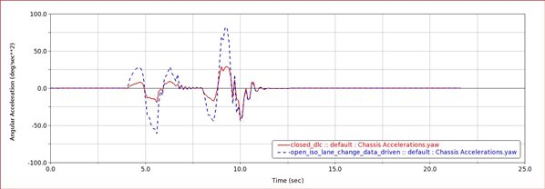

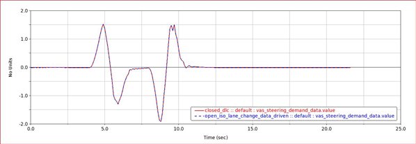

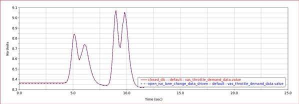

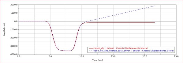

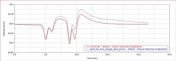

Can you give me some advice about my results of comparison. I wanted to compare double lane change with some maneuver as open loop. I did it this way:
  1. I have created Double lane change simulation.
  2. In PPT i saved data from all demands (vas_steering_demand_data,_vas_throttle_demand_data,...)
  3. Made open loop dcd file
  4. From event generated during standard DLC, i changed every input to open, and attached my dcd file
  5. Made file driven simulation
Some results are perfectly same:
steering_demand
throttle_demand
The biggest difference are in results in accelerations i.e.:
yaw_accelerations
and in this
lateral_displ
Is this caused with different longitudinal velocities of vehicle (open loop model is going faster, mdi driver in closed loop is correcting velocity ???)
longitudinal_velocity
or i am wrong with my assumption.

  • Jesper Slattengren
    0 Jesper Slattengren over 5 years ago
    Have you tried to tighten error and hmax?
    There can also be some of the magic applied in the initialization/ static setup that affects the whole history.
  • jozef.bucha
    0 jozef.bucha over 5 years ago
    Thanks for reply, i will try to play with error and hmax
    Also i will try to check msg file ​
    My first idea was that results will be samé
    Jozef​
    I have not had much luck with that in the past.
