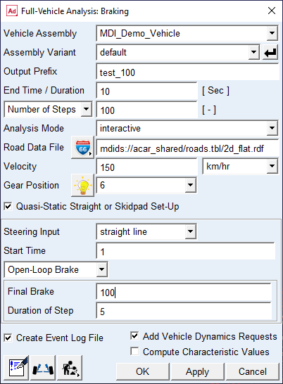

But when i want to make full vehicle analysi:braking with demo vehicle input for final brake value is accepting 0-100, from this it looks like brake demand is in percents??

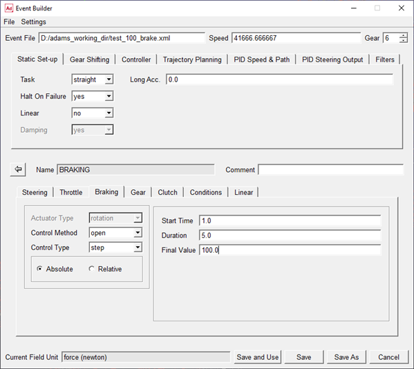

Event from this maneuver shows
Capture
Note current field unit (Newtons).

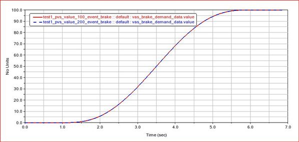

Changing pvs_max_brake_value in brake template is AFAIK not changing brake demand
brake_demand

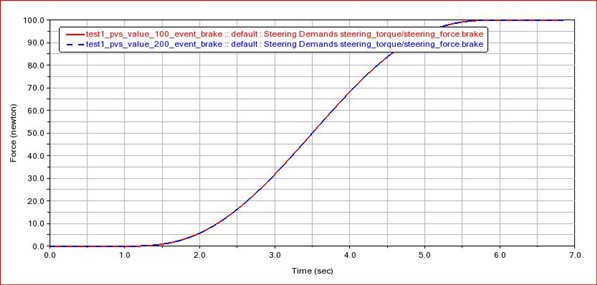

this plot is unitless, but request for braking demand is also in tesrig/driver_demands/brake, which produce same results, but with force on y axis.
brake_demand_force

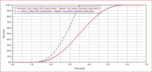

manualy changing value for braking in event builder to 200, produce logical result for me, step is changing more rapidly to achieve 200 in same time as step 100, but again it is cutted to value 100.
brake_demand_force_step
So what is actually brake demand force? max value is maximum 100? I am confused
