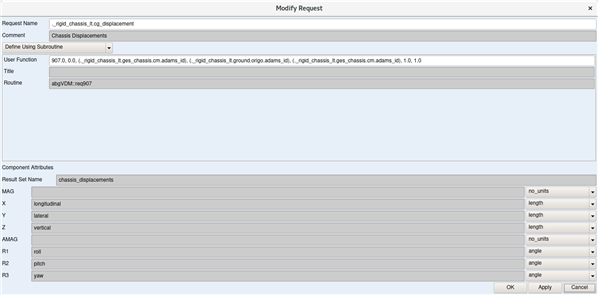

Hello, I want to make request same as 907 (measuring displacement) but with functions:
request_subrutine

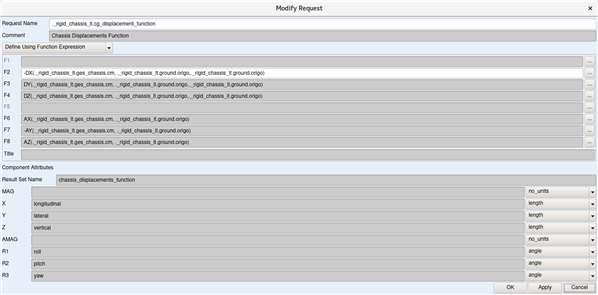

My request using functions:
request_function

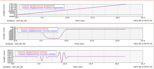

To obtain same translational displacement for F2 i had to add minus sign:
comparison_1

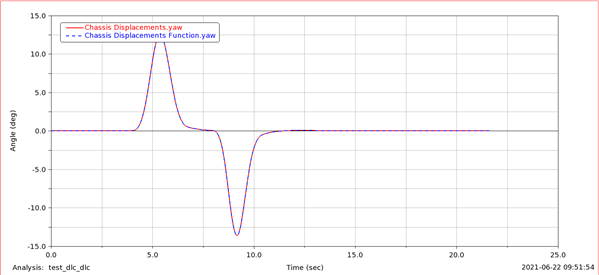

Problem is with angles. Yaw angle values are perfectly same:
comparison_yaw

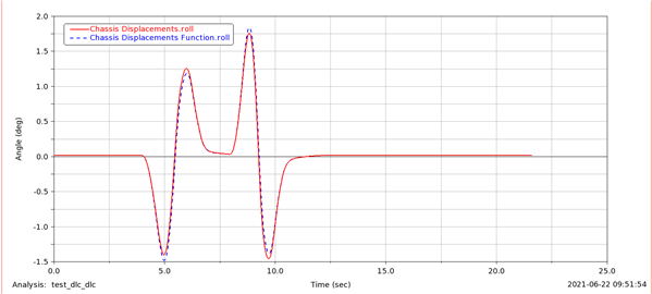

Roll angles are not perfectly same:
comparison_roll

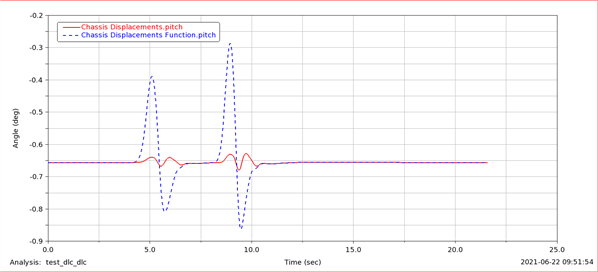

Biggest difference is in pitch angle. To have same sign of values i have used minus in F7 function of request:,
comparison_pitch
Why are pitch angles so different? Is there some problem in my function request?
Also what I do not understand is why subrutine 907 for longitudinal displacement is giving positive values (i think vehicle is going in minus direction of GCS).
Thanks

    Joseph, the functions AX, AY, AZ does each expect that the angle around the other two axles are small. And you simply get the wrong sequence of angles when using them. Think for example that the vehicle have yawed 90°. Then you claim that the roll is the rotation around the global X-axle? At this position, when the vehicle travels along the global Y axis, the roll should be measured around the global Y. So AX, AY and AZ are unsuitable for this purpose.
    Luckily there exists the functions YAW, PITCH, ROLL that actually measures the rotations in the right sequence. Use those instead and it probably will work out better for you.
