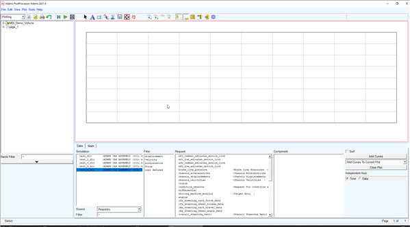

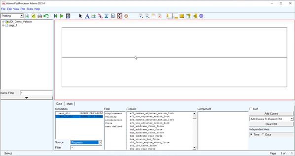

How is Request Activity working? I am trying to turn off requests using Tools/Request/Request Activity.
aview_ITxPAq2vcz
After Apply, program informs that all Request will be turned off
But in PostProcessor i am still having all Requests.
aview_0ymPPLh7fi
Am I missing something?
Thanks
Jozef

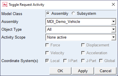

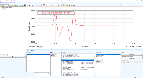

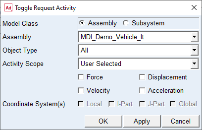

    It works just partially, using Activity Scope = User Selected, and deselecting all options, remove all requests except bump stop requests:
    aview_TismrXMWoA
    also i have noticed that then it is possible to turn on back all request using Activity Scope = All Active
    after that it is working turning off Activity Scope = None Active, and all requests are turned off (also bump stop request)
    aview_Aa8qgD6PAK
    Can you check it
    Jozef
