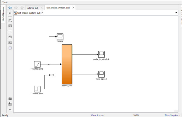

How to use local site solver with cosimulation?
MKvist
MKvist over 4 years ago
simple_simulink_adams_sub
I'm trying to run a cosimulation with an A/Car model with Simulink as the master. My A/Car model use some subroutines that is included in our site solver, but the cosimulation use the standard solver. I have tried to use the "User Defined Library Name" when I export my plant, but I still get the same error.

In the bat-file ctrlsctrl....bat, that is created when I push the run-button in Simulink, there is a row "set MDI_SOLVER_USER_LIB=C:\MSC~1.SOF\ADAMS_~1\2019.2\win64\acar_solver.dll". This points to the standard solver and I guess that it could be a clue of why it doesn't work as I want. Where do I set the value of this environment variable?

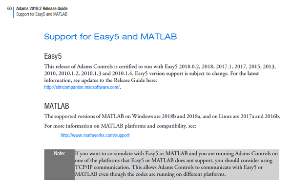

  • Alexis Del Rio
    0 Alexis Del Rio over 4 years ago
    Hi Markus,
    To start with, it doesn't seem like Adams 2019.2 supports Matlab R2019b. please have a look at adams_20219_2_doc_release.pdf page 60:
