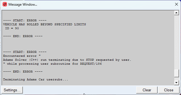

Hi everybody, i want to reorient full vehicle assembly (MDI_demo_vehicle) in Adams 2023.4.1, i want to rotate vehicle (180,180,0).
I have tried all combination to use or not (Keep Current Road Position, Retain Parametrization) but after rotation vehicle is not able to make Static Equilibrium Analysis
static
I have tried rotation (180,0,), in that case i do not have problem with static equlibirum
also rotation (0,180,0) and then again rotation (0,180,0) broke model
Any idea what in model can be cause thi issue
Thanks in advance
Jozef

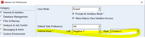

  • Rishikesh Mokashi
    0 Rishikesh Mokashi over 2 years ago
    Hi Jozef,
    Would changing the vehicle orientation using the settings below help?
    In older versions this was accomplished using below variables in the CFG file:
    Rishi
