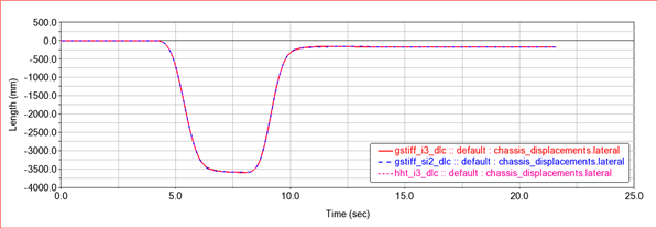

Can anybody tell me difference of vas_steering_demand value in postprocessor with different solver settings (Gstiff/I3, Gstiff/SI2, HHT/I3)
All simulations are done as DLC with speed 50 km/h with (MDI_Demo_Vehicle)

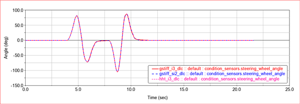

Results are pretty same (i.e. lateral disp, steering wheel has same angle)
lateral_disp
steering_wheel

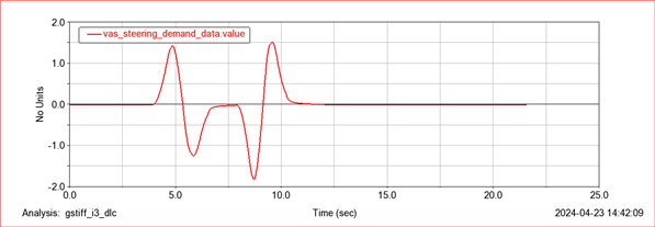

Steering demand during DLC using gstiff_i3
steering_demand_i3

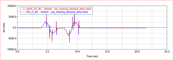

Steering demand during DLC using hht_i3 or gstiff_si2
steering_demand_hht
I do not understand value of steering demand, why is so much different while using hht or si2?

    Answer was in message log:
    Overriding Trans/Rotation actuator with Force/Torque actuator. This is done to accommodate SI2, SI1 and HHT integrators.
    You can force use of original actuator by setting
    MSC_ADAMS_VDM_SI2FLAG to 0.
    Thanks @E-ondrej Petergac​
